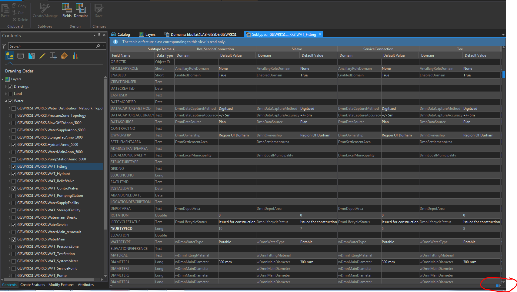

The 'pane' that shows subtypes does not seem to be scrolling properly.  See the images below.  For this particular feature class, there are about 10 subtypes, but I can only view 4 in the pane.
Here is the pane when scrolled to the left:

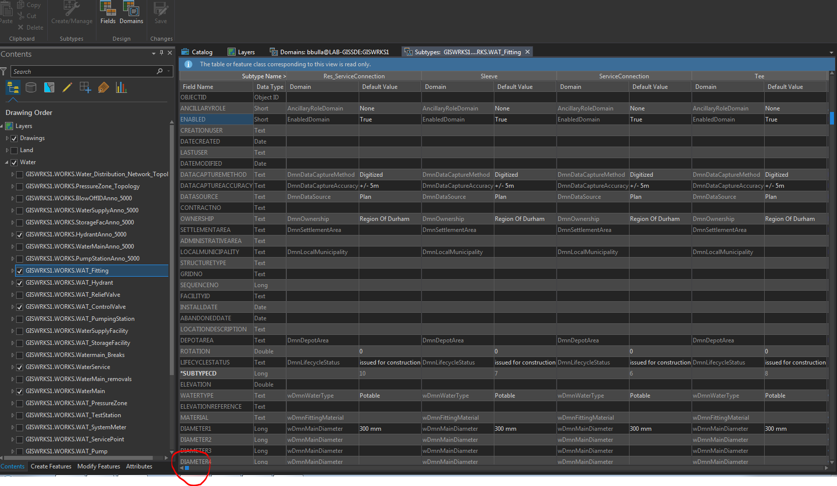

Here is the panewhen scrolled to the right;  the data in the pane is not panning with the scrollbar.
Or am I doing something wrong??
Also when scrolling up/down the Field Names at the left side do not scroll with the subtypes on the right.  It's hard to explain, but it seems like all the columns scroll in pairs, independent of all the other columns.
