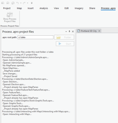

I attached a sample add-in project that opens all .aprx projects under a given folder (including all .aprx file in subfolders) and checks if the aprx has an open Map Pane, if it doesn't have an open Map Pane, the add-in takes the first Map and creates a map pane, then saves the project file.
Note that you might get prompted for input at some time and execution is slow at times because the add-in is using time outs for some operations.
To use the app, set a start folder and click the start button.

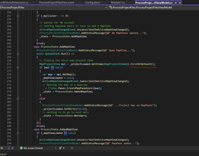

After testing the tool for a little while I noticed that it will open the first aprx file and open the map pane view but the next one it says it already has a map pane view open even though it doen't have one open, Also once I stop debugging and restart debugging to run the addin again in Pro it will go to the next aprx and open the Map Pane, but I have to run it multiple times.  I have been looking in the "Helpers for Project processing" region my, for some reason it sees the rest of the aprx files as having an opened map pane view even though they don't.  is it possible that when it checks the first aprx that it is still holding on to that map pane as open in the next Aprx file?  I  noticed it is checking for a list of map panes using IEnumerable<IMapPane> Method, I figured I could add an ifelse statement or would changing the syntax where it checks for open mapViews be better?
Wolf
by Esri Regular Contributor
Can you send the log output showing the events ?

I have attached the output file from the debug session, I was also able to direct the tool to a specific aprx file just to test it because I was curious if it was the .FirstOrDefault(); method that could be confusing the tool as shown in the snippet image.  I added the below to the code and it worked as I thought it would where it ignored the other 2 aprx files but saw the one called out.
.FirstOrDefault(item => item.Name.Equals("Alfalfa_SD_2020"));
