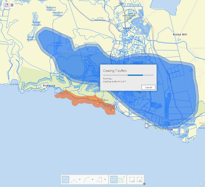

The above sample code displays the progressbar like this:
