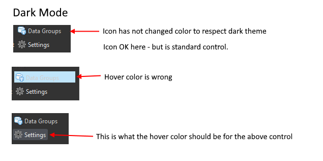

I'm struggling to get a custom control to behave like a standard button on the ribbon.
My custom control is basically the same as a medium size button (text and image), a little notification badge appears on the button which is my embellishment and irrelevant to this question so I'll leave that out.
When I mouse over in dark mode it should be dark grey (like other standard controls), but it shows up as a pale blue (I think the same as the light theme).
Also the esri image I have embedded into the button doesn't seem to respect dark mode.
The following image should help explain:

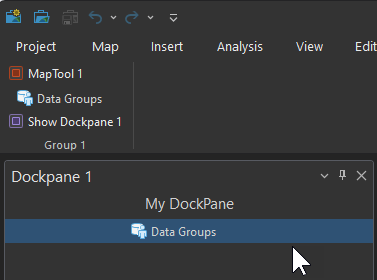

Now you get the same 'theme' behavior as if you use the Button in a Dockpane:
Ribbon - mouseover:
Dockpane mouseover:
