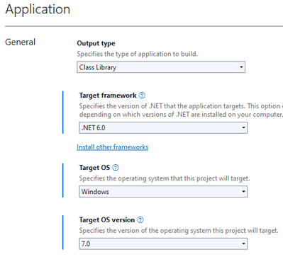

Prior to upgrading your add-In project to .Net 6 and ArcGIS Pro 3.x, you should upgrade Pro on the developer machine to your target Pro version.  Secondly, your SDK version needs to match the Pro target. If you are pulling the SDK from the web it will get the 'newest' SDK by default, which is now Pro 3.1. If you need Pro 3.0 SDK then a manual install of the SDK from ESRI downloads site is required.
Look in Project Properties and Build Configuration to update .Net Framework versions.
