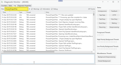

 I think i found the problem in the TimerTick state machine code.  The variable _mapViewLoaded was not properly cleared before subscribing to the 'ActiveMapViewChanged' event.   I attached the fixed code.  This code is also using the ArcGIS Pro event logger.  To start the Pro diagnostic monitor you can use the Ctrl+Alt+M key sequence to start it, or the /enablediagnostics command line switch (see ProGuide Command line switches for ArcGISPro.exe · Esri/arcgis-pro-sdk Wiki (github.com) )
Make sure to filter by 'ProcessProjectFiles' when viewing the log.
