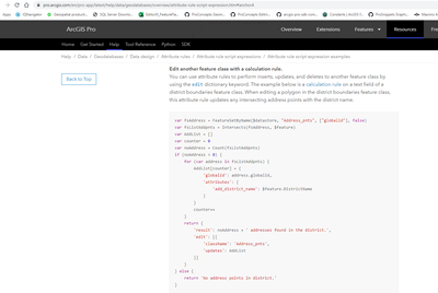

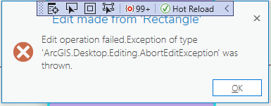

Our team is trying to use Arcade to do some data updates without success and I have reduced the update to be the simplest possible. Basically, this is to copy the data to 'notes' when this field changed. I am on pro 2.7 and I am using file geodatabase. Could anyone see what is wrong with this arcade expression or do I need to configure something for update via arcade? Thanks in advance for any helps! Following are the screenshots of the error we received and the arcade expression.

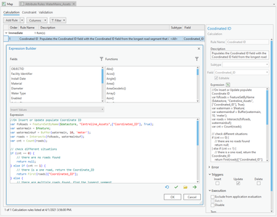

Thanks so much, @SarahHartholt. I have tried your first example and it works great for its use case and it also helps me clarify some concepts! For your second example, I am wondering how do you define the attribute rules since the trigger and receiver are different. I guess you will need to define the rule for "watermain" on "coordinated_ID" to receive the change. How do you define the trigger from Centreline_Assets? A screenshot of your rule definition like in your first example should help a lot!
SarahHartholt
It's a calculate rule that is set on my watermain feature class. The trigger is Update just like the first example. When I make a change to a feature in the watermain feature class (the receiver), the arcade expression executes.
I think the key for you is this line which calls the Centreline_Assets layer in my map. (the giver)
var fsRoads = FeatureSetByName($datastore, "Centreline_Assets",["Coordinated_ID"], True);
it is telling the expression to look in the map document ($datastore) for a layer called Centreline_Assets, and to grab the Coordinated_ID field in its attribute table.
