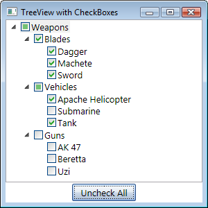

Right now, I’m simply trying to replicate the code from a windows application where we see a treeview with checkboxes.  The code for that project can be found here: https://www.codeproject.com/Articles/28306/Working-with-Checkboxes-in-the-WPF-TreeView
The end result is an application that looks like this:
And for example, if the user unchecks the Blades checkbox, all the childs (Dagger, Machete and Sword) are then unchecked.
