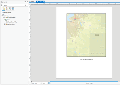

  This is where the element originally is

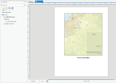

In the next image I have added a mapframe and moved the text element.

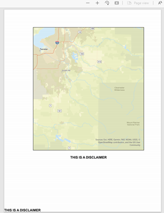

This is what happens when I then export the layout.

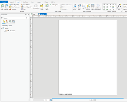

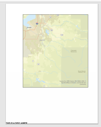

Next I completely removed the text element from the layout using the TOC and this is what happened.
