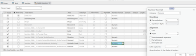

I have a layer feature table with fields joined from a plugin datasource. How can I programmatically change the number format on a joined field?

The code shown below is after a join. I do not see a change to the formatting in the attribute table after this executes.
var layerDef = layer.GetDefinition() as CIMFeatureLayer;
JoinLibrary.UpdateJoinTable(layerDef, oldTableName, newTableName); // setup join here
layer.SetDefinition(layerDef);
// Attempt to update numeric format
var fieldDescriptions = layer.GetFieldDescriptions();
foreach (var fieldDescr in fieldDescriptions)
    if (fieldDescr.Type == ArcGIS.Core.Data.FieldType.Double)
        var custNumbFormat = new CIMNumericFormat();
        custNumbFormat.ZeroPad = true;
        custNumbFormat.RoundingValue = 6;
        fieldDescr.NumberFormat = custNumbFormat;
GKmieliauskas
You need to set back field descriptions after modifying using SetFieldDescriptions method.
KarlBeal
Apologies I missed that line in your original post. Works as expected now.
