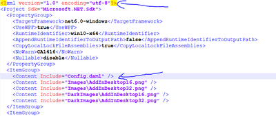

KThomasson
I would also like to add that there is one more thing to look into if you have this issue, for some reason this issue had come back up and once we had looked at the CSproj code we noticed it was missing two lines that are needed for the addin to be created after it the tool is built.  see below.
