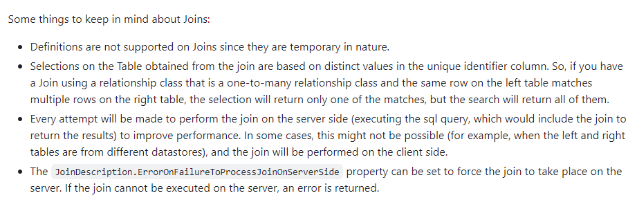

Please refer to the Joins conceptual doc.

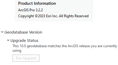

We are using ArcGIS Pro 3.2.2 with a file geodatabase version 10.0.  See images below for confirmation.
