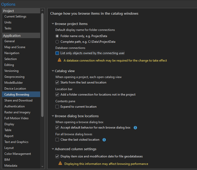

@SumitMishra_016 , it seems like the catalog's view-only behavior for the owner, and the API shows everything the user has access to.
SumitMishra_016
Hi @Aashis
List only object owned by connecting user was not checked but it was still showing correct feature classes.
Can I use this(List only object owned by connecting user) in code?
