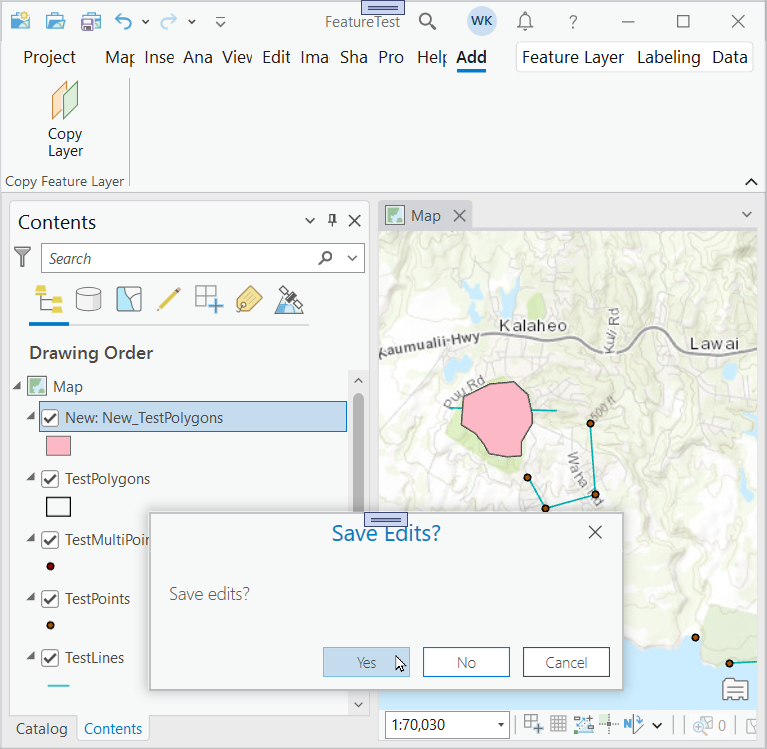

Wolf
by Esri Regular Contributor
I attached a sample that creates a feature class, adds that feature class as a layer to the map, and then copies some data.
To delete the content of a whole table or feature class you can use the DeleteRows  method for the Table or FeatureClass.

You can use this snippet to delete all data from a layer:
        var theFeatureLayer = MapView.Active.Map.GetLayersAsFlattenedList().OfType<FeatureLayer>().FirstOrDefault();
        if (theFeatureLayer == null)
          MessageBox.Show("Unable to find a FeatureLayer in the Table of Content");
          return;
        QueuedTask.Run(() =>
        theFeatureLayer.GetTable().DeleteRows(new QueryFilter () );
and the code to copy data from one layer to another is included in the code above.
// copy some data
await QueuedTask.Run(() =>
  // create an edit operation
  EditOperation copyOperation = new EditOperation()
    Name = "Copy Data",
    ProgressMessage = "Working...",
    CancelMessage = "Operation canceled.",
    ErrorMessage = "Error copying polygons",
    SelectModifiedFeatures = false,
    SelectNewFeatures = false
  using var rowCursor = originalLayer.Search();
  while (rowCursor.MoveNext())
    using (var row = rowCursor.Current as Feature)
      var geom = row.GetShape().Clone();
      if (geom == null)
        continue;
      var newAttributes = new Dictionary<string, object>
        { "field1", 1.0 },
        { "field2", 2.0 }
      copyOperation.Create(newLyr, geom, newAttributes);
  // execute the operation onoy if changes where made
  if (!copyOperation.IsEmpty
      && !copyOperation.Execute())
    MessageBox.Show($@"Copy operation failed {copyOperation.ErrorMessage}");
    return;
// check for edits
if (Project.Current.HasEdits)
  var saveEdits = MessageBox.Show("Save edits?",
                "Save Edits?", System.Windows.MessageBoxButton.YesNoCancel);
  if (saveEdits == System.Windows.MessageBoxResult.Cancel)
    return;
  else if (saveEdits == System.Windows.MessageBoxResult.No)
    _ = Project.Current.DiscardEditsAsync();
  else
    _ = Project.Current.SaveEditsAsync();
