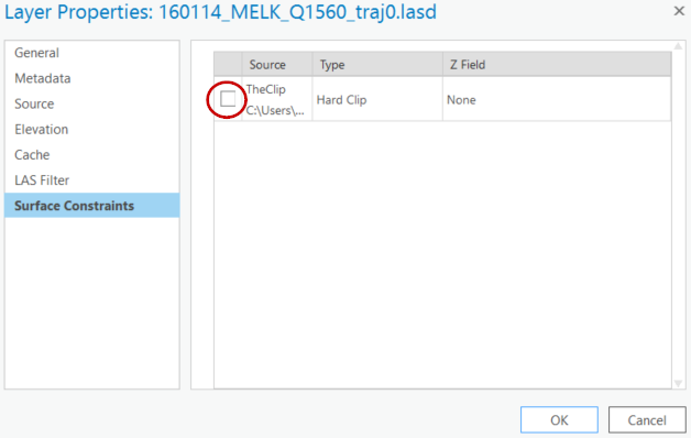

I have added a surface constraint to a las dataset but it does not automatically enable the constraint and I am wondering how I could enable it using the SDK?
When I add the surface constraint to the las dataset while it is loaded in the map, the properties get updated but I have to manually go into the properties and select the checkbox to enable the constraint or I have to remove the las dataset and re-add it.

The AddFilesToLasDataset tool should turn on the added constraints by default. We're going to treat that as a bug to address.
