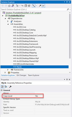

As for libraries referenced in your Add-in make sure that you set the 'Copy Local' to yes for that library file:
This should ensure that the dll is copied into the add-in's executable folder.  Having not used GDAL, I would suggest following the debugging steps suggested by @DHuantes
