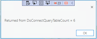

Here's the result.
Can you try the attached solution in your system after changing the connection/table info?

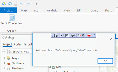

Unfortunately the 'dll loading' bug is located in the Microsoft.Data.SqlClient managed code, so as soon Microsoft fixes this problem, your add-in will work with the Microsoft.Data.SqlClient Nuget.  There is nothing the Pro SDK can or has to do to fix this.  The problem is caused by the assumption that the executing assembly's path (ArcGIS Pro's exe) is the same path from which the add-in is running.  This is incorrect as the addin is loaded at run time from a different folder that ArcGIS Pro.exe, in my case the add-in executable folder is under: C:\Users\wlfka\AppData\Local\ESRI\ArcGISPro\AssemblyCache\....
To test if this is really the case I simply copied all native  Microsoft.Data.SqlClient  dlls into the Pro executable folder with is:  C:\Program Files\ArcGIS\Pro\bin in my case.
The same add-in that didn't work before is now working without problem, because is finds the native dll under the wrong location.
before i copied the native dlls:
After:
