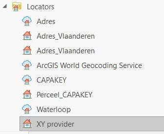

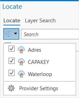

Hi,
The XY Provider in the Locate-window has recently disappeared in my ArcGIS Pro at Locate:
The locator is still in the project at the Locators tab, but it is not recognised as a locator when you want to add it to the Locate window via the Provider settings:
I suspected that it was due to the connection with the ArcGIS World Geocoding Service but it doesn't appear to be the cause.
Anyone know how they can get the XY Provider back there?

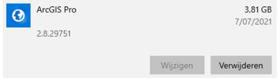

AndreasB
Hi @Robert_LeClair , thanks for looking into this, unfortunately a soft reset had no effect on this issue.
When trying to repair the software, this option is greyed out.
Any other thoughts/ways on how to fix this?
