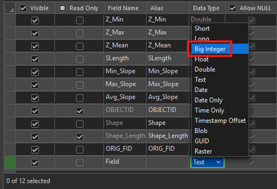

Data type         Storable range                                  Size (bits)
Long integer   -2,147,483,648 to 2,147,483,647  32
Big integer    -9,007,199,254,740,991 to 9,007,199,254,740,991   64
ArcGIS field data types—ArcGIS Pro | Documentation
It looks like you want Big Integer.  See if your situation can use them.

In addition to what Dan said, you may also consider a string to store these IDs, but I believe the functionality may rest in the IDs being integers, and if that's the case, then I agree with Dan's suggestion!

If you're truly set on making these into integers, then what Dan mentioned is your best bet, making the field a Big Integer to hold a number as large as your 15 character number.

The reason that this is happening, 290950135022002 turning into 2147483647, is due to a concept called Integer Overflow and what is happening is the 64-bit value 290950135022002 exceeds the 32-bit integer limit on the integer data type which is 2147483647, if something exceeds this value, it defaults to 2147483647 in ArcGIS Pro.
In order to get a value higher than 2147483647 to be present in the value area, you WILL NEED to update the column value type to Big Integer as Adrian and Dan have mentioned, or update it to Text with a length sufficient to fit the value you're wanting to add. Due to database limitations these are the only options to make this happen.
