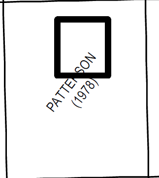

I am trying to recreate this style of label but have not found any settings that allow that. I expected it to be in the symbol and then rotation angle but that is grayed out

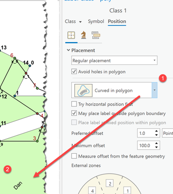

label points might be easier, but you can get some effect depending on your polygons shape

Is there any change to this?  I am also looking to add polygon labels and position them at a 45 degree angle.
All the other labelling properties are really useful in scaling the labels etc. etc. but the label needs to be at 45 degree angle from horizontal (not related to the boundary of the polygon just 45 degrees from horizontal axis) , it is possible to do for points but not for polygons?  I don't want to convert to annotations because I want to keep the scaling capabilities.

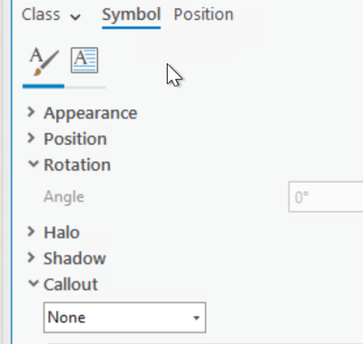

We're also wondering why Angle settings are greyed out when working with labels. Are there any updates on this?

This is super frustrating. Also wondering why something so simple would be so complicated to achieve. My Rotation - Angle option is also grayed out as pictured above by Amanda.
