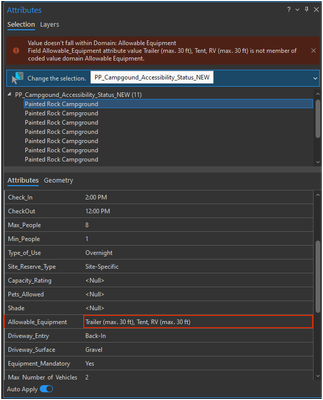

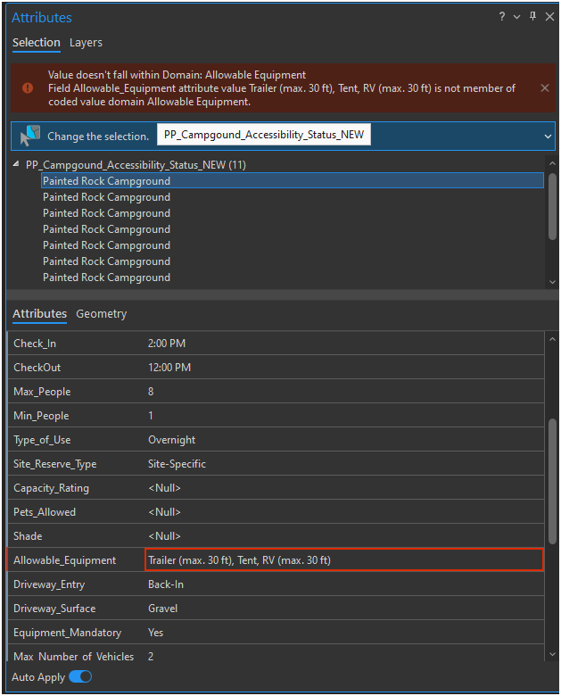

Then I went back to the MapView again and selected a new feature and sometimes I get these.
Funny thing is why does it do that even though I scroll down each feature and all of them in the Allowable Equiment is already filled ?

Can you share your Coded Values and Descriptions?  It may match your Description but not your Coded Value.  Also look out for slight differences or trailing spaces.

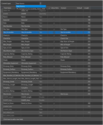

For Fields
For Domanis

I think you accidentally pasted the Subtype screenshot twice -- can you paste the domain menu screenshot showing the domain code/values you are having issues with?

Something that may help you as you track this down...if you are needing to edit the feature's attributes and the error is preventing it,  uncheck 'Enforce Attribute Validation' in the Backstage Options, Editing tab.  With this option unchecked, there will be warning notification, rather than and error notification, and you will be able to modify the data.

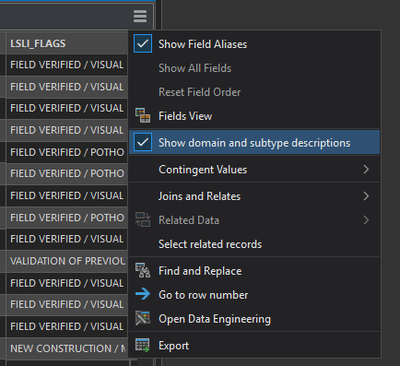

I find when diagnosing the warnings like you're seeing where domain coded value is not being recognized in a selected feature:
For that layer in your map, if you open the attribute table, there is an option to specifically show domain CODE values instead of DESCRIPTION values. This also changes the behavior of what you see in the attribute pane (but not pop-ups, I believe; you have to change that field value display behavior separately by using an arcade expression to show the domain code value rather than description).
This at least helps you see what the 'actual' value of that field is.
Changing domain description values in the domain  menu should automatically reflect the new description value in your attribute table/attribute pane, unless ArcGIS Pro is being glitchy you may want to close and reopen the project.

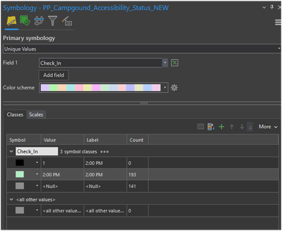

Look at the picture scroll down here.  Look at the Site Accessible and I have two "No"'s and when I fixed it and refresh the count  One of the No count changes to zero.  It means the No now have only One label...
Example I just fixed Check-In and it does not refresh the Value "1" because I move the clock 2:00PM  from Value 1 to 2:00 PM

I am reviewing again here and found some strange here ....
In that picture you see I have two separate No here.. that is the problem...
