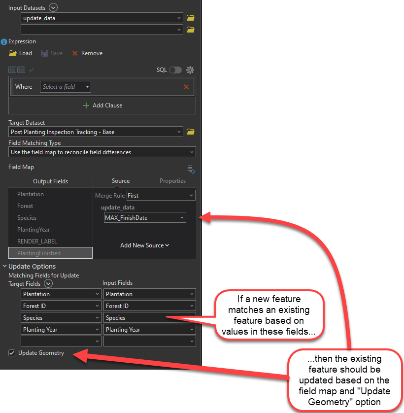

Hi All. I'm using the Append tool in ArcGIS Pro, and in arcpy to try and both ADD new features to a feature service in ArcGIS Online (from a feature class), as well as UPDATE existing features if they match (Upsert).
From reading the documentation here I understand that the tool should look for features with identical attributes within the fields listed under the "Update Options" section. If a feature in the Input Dataset matches a feature in the Target Dataset based on those fields, then it will update all the fields listed in the Field Map (as well as the Geometry if that option is enabled at the bottom of the pane). If no matching feature is found, then those features in the Input Dataset should be Appended as new features.
However, the behavior I'm getting doesn't seem to match that. When I have no Update fields listed, the features in my Input Dataset are being appended as New features as expected. When I do have fields listed under the Update Options section, I am seeing matching features update but new features are not being added as I would expect.
Can someone clarify if there is a problem somewhere, or if I have my understanding wrong and the Append tool is either Add or Update, not both?

Input field(s) is for matching values. I.e. a unique ID field, or multiple
fields that could uniquely identify exisiting records to updated.
Field maps and geometry is for what attributes get pushed.

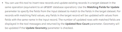

Documentation isn't really clear, and somewhat contradicts itself, but:
  • You can use this tool to insert new records and update existing records in a target dataset in the same operation (equivalent to an UPSERT database operation). Use the Matching Fields for Update parameter to specify the fields from the input dataset to match to the fields in the target dataset. For records with matching field values, any fields in the target record will be updated with values from fields with the same name in the input record. Geometry will be updated if the Update Geometry parameter is checked.
This tends to suggest that it will only update fields that have the same name.  Almost as if the Field Map is ignored for the upsert operation.
