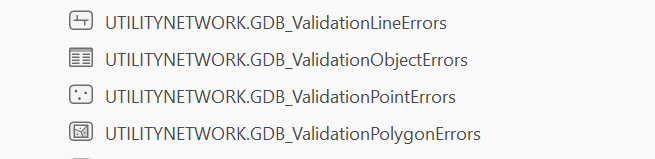

  1. The validation tables are created in the EGDB

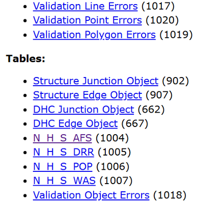

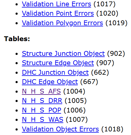

  2. I've manually added them to the feature layer and overwritten the published one. The checkbox 'Validation' has been enabled during this process
     "supportedExtensions": "FeatureServer, NetworkDiagramServer, UtilityNetworkServer, ValidationServer, VersionManagementServer",

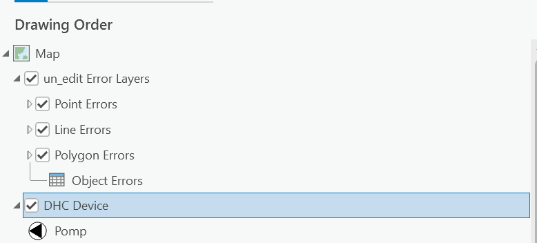

  3. Then in a fresh map I've added my UtilityNetwork with associated layers. After adding these layers I can right-click on DHCDevice and select 'Add Error Layers'. The error layers are added to the map.

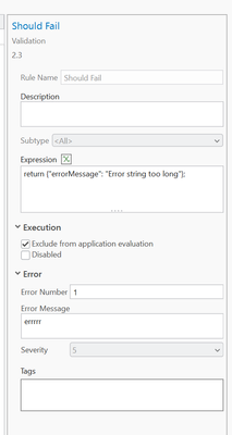

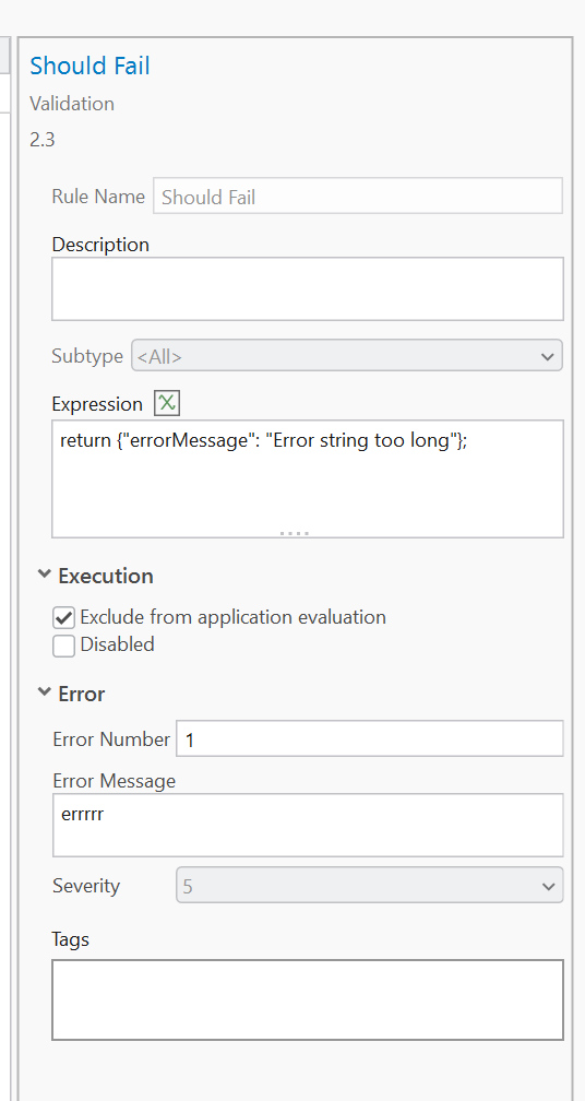

  4. I create a very simple validation rule (on DHCDevice), one that should always fail. Just for testing purposes

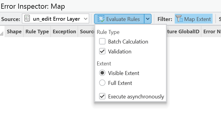

  6. However when starting the validation. Just by zooming into one DHCDevice and pressing the validate button. Not much happens. The screen 'Validating' pops up but after that nothing. I expect: the validation status of the object to change and a record to be created in the Point Error table
    'Execute asynchronously' turned off or on doesn't matter seemingly.

2) Does full extent work?

if that doesn't work Finally try the following.  Delete the validation rules, delete the error tables, then add the validation rule again, this will generate the error tables. Makes sure you are using a branch version workspace when you do that.

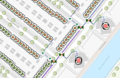

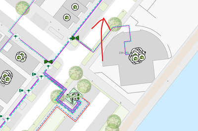

Thank you for your reply! The triggered attribute rules show up in the logs and after zooming out more I could see why.
The extent window is offset by some x,y. Is it possible to reproject the error tables from 4326 to a local CRS? That will probably fix this issue
