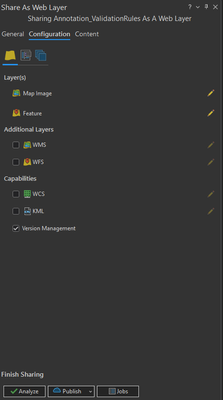

However, it seems like there is no option of "Enable Validation capabilities" on "Share as Web Layer" pane.
According to the step 9 of ESRI doc (link is below), it says "Optionally enable the Validation capability on the feature service. This is not required when sharing datasets with attribute rules but is required if you want the feature layer to participate in validation workflows. Click the Configuration tab, and click Validation under Capabilities.". But I cannot find the Validation under the Capabilities in Configuration tab (See screenshot below). How can I enable it if there is no option in the pane?

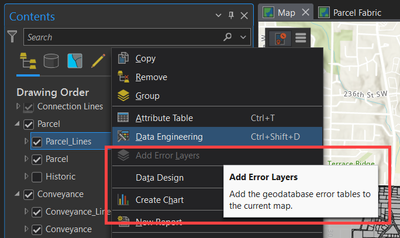

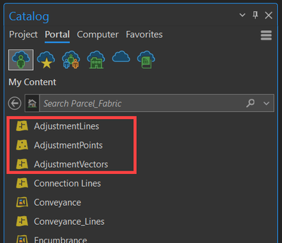

In the feature service do you see the Adjustment Lines, Points, & Vectors feature Classes?
If so, when right clicking a feature and hovering over the 'Add Error Layers' do you see this message?
~Jake
HNTZK46

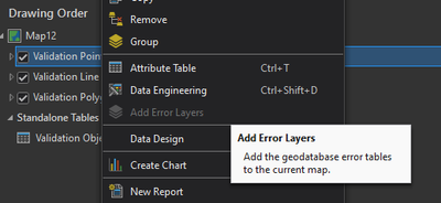

No, I don't have those layers. I have included "four error layers" that were automatically created when the validation rule was established on the enterprise GDB. What is the difference between your "AdjustmentLines" layer and "Validation Line Error" layer?
Even if I right click on one of the four layers on ArcGIS Pro map, "Add Error Layers" are greyed out.

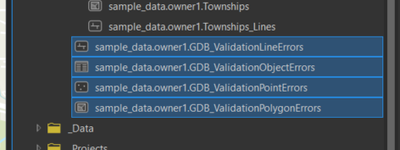

My process for successfully utilizing the Error Inspector for validation rules is as follows:
1. Create Validation Rule (automagically creates the 4 validation features GDB_ValidationPointErrors, GDB_ValidationLineErrors, GDB_ValidationPolygonErrors, & GDB_ValidationObjectErrors in the egdb)
2. With a map with the data with validation rules applied, add the 4 validation features to the map to publish
3. In the Share As Web Layer Configuration tab check 'Validation', Publish

HNTZK46
I think the step 3, "In the Share As Web Layer Configuration tab check 'Validation', Publish" is problem for me.
In my case, I don't have the option, "Validation" in configuration tab for some reasons. I am using Pro3.0, which should be available for this setting according to ESRI doc. How can I make this option available?

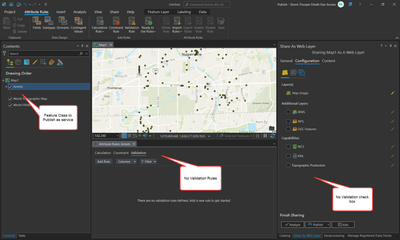

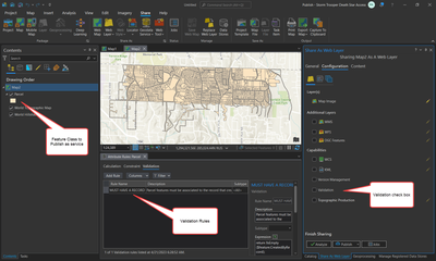

Some reference examples.
No Validation rules
With validation rule
Map with feature with validation rules AND the Error layers added to publish

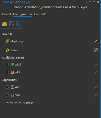

HNTZK46
Ok, so on your interface, you have the check box for "Validation". However, in my case. there is not option of "Validation check box" somehow even if I use the version 10.8 of Enterprise GDB.
Yes, I published as editable feature service. The validation rule was successfully configured and saved it before publishing it. Also, all other required configuration were matched in accordance with ESRI doc.
