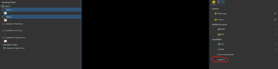

Just for troubleshooting purposes, can you add to a brand new map and non-annotation feature with validation rules applied to it. Do you get the validation check box then?
HNTZK46
Yes, the validation check box came out when I used non-annotation features with validation rules applied - please see below.
