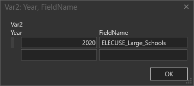

How can I use an Inline Variable as a field name in Select Layer by Attribute in code block.
I want to get the field name from multivalued variable table rather than from Attribute Table.  In Select Layer by Attribute   Year and %VariableFieldName%  value in "where clause" comes from string Var2 as shown in the Image.

So I have changed the SelectLayerByAttribute and put the values (a and b) from string VT1  in curly brackets. where {a} = Year field and {b} = !ELECUSE_Large_Schools! field in attribute table.
Code below is a snippet from model builder Python in Arcpro.
Now this runs with no error message but it only selects the last part of the  VT1 string.
How can i make it run for the whole VT1 variable?
