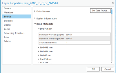

The raster comes in with the specific wavelength information associated with the file:

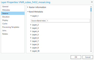

After my mosaic process to bring several of these hyperspectral image cubes together, I am left with layer 1, layer 2, layer 3, etc.:

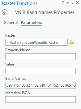

I have tried using the Key Metadata function template to assign band names to my files, but because the output only exists in my project, it seems that I would need to export this "in memory" file to save the band name information.
I would like to avoid replicating these 20+ GB files as I have quite a few of them.
Is there a way to assign band names from my initial file (ideally) or assign them from a comma separated list as in the raster function tool?

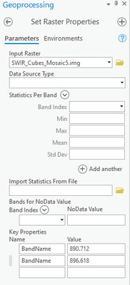

Thanks @Luke_Pinner for the suggestion! I had tried this tool, but was looking for something less manual. I have 270 bands in the SWIR and 274 in the VisNIR and it appears I have to type in the wavelengths one by one:
I am not a python person, but maybe that is the answer...

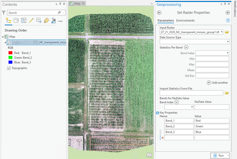

I did find out some critical information about how the tool works for non-hyperspectral rasters. To update the band name information, the "Name" field in the Key Properties section should contain the current band name (e.g. Band_1, Layer_1, etc). The help documentation was a bit ambiguous.
Set Raster Properties to update band namesSet Raster Properties to update band names

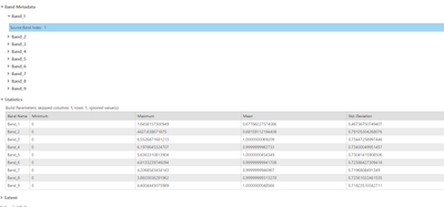

I also found the Get Raster Properties tool to be helpful to gather my hyperspectral band information. I used the tool on an original raster with the band properties still intact:
Get Raster Properties to collect band namesGet Raster Properties to collect band names
Using the wavelength function and leaving the band selection blank, I was able to run the tool and view details. The output printed a list of all the band names and the wavelength ranges. I copied this text and brought it into Excel where I was able to break apart the strings and format all the information properly. This made it easy to build a python script to update the Set Raster Properties tool.

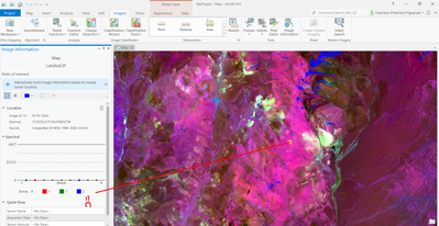

I have the same problem regarding viewing the spectral profile and the information with the bands.
I have worked with ENVI to generate band ratios and later I joined together the different band ratios and bands. When I upload the new raster it didn't show the wavelengths of the bands and the spectral profiles are not working.
