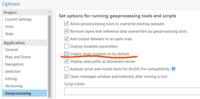

How do you keep this toggle on?  I'm having to click it on each time - and I would rather just have it on permanently.

Go to Geoprocessing Options:
Read more about that setting and considerations to keep in mind here: https://pro.arcgis.com/en/pro-app/latest/help/analysis/geoprocessing/basics/geoprocessing-in-an-edit...
