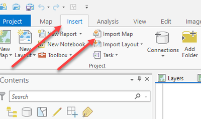

Extract Package GP tool or Import map seems to work, at least with 130Mb file.
If import doesn't work, might try the Extract method.

I have tried importing the map and it was/is not working.

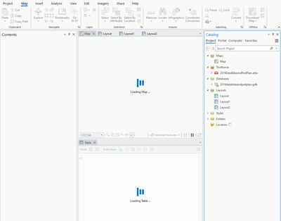

I tried with a .ppkx instead as well, and although all maps, layouts, databases, etc. are recognized, the system gets stuck on "loading". I left ArcGIS Pro running for hours with no luck.

any chance there may be Excel data in the map, and, do you have the drivers/redistributable installed?
Seems I remember project hanging forever and not opening in this situation in the past until I installed all the appropriate files.
Otherwise, not sure what to try next.  Since it extracted, but can't open the map, you may just load all the extracted data directly and see if something breaks.
