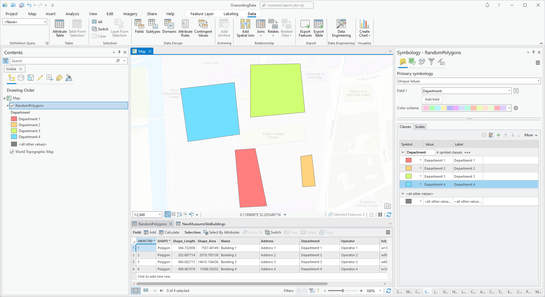

Maybe I'm missing something but is there any way to configure Pro so that when you have a layer symbolised using 'Unique Values' that you can toggle on/off individual sub-layers?  The only way I can find to do this to create separate layers for each value using the Definition Query function.  This is fine if my layer only has a small number of unique values, but if it has a lot of values this is really tedious to set up.
For example, in the image below I have configured the symbology to use the Department attribute, but I want to be able to control which departments are drawn on the map individually:

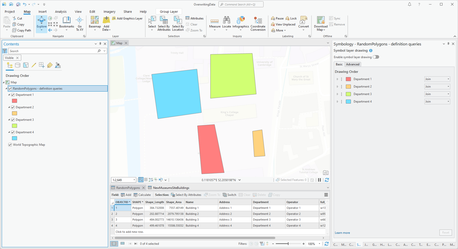

I can achieve the behaviour I want by creating four separate layers using Definition Queries:
This gives me what I want but is a pain to set up if you have multiple unique values in the selected field.

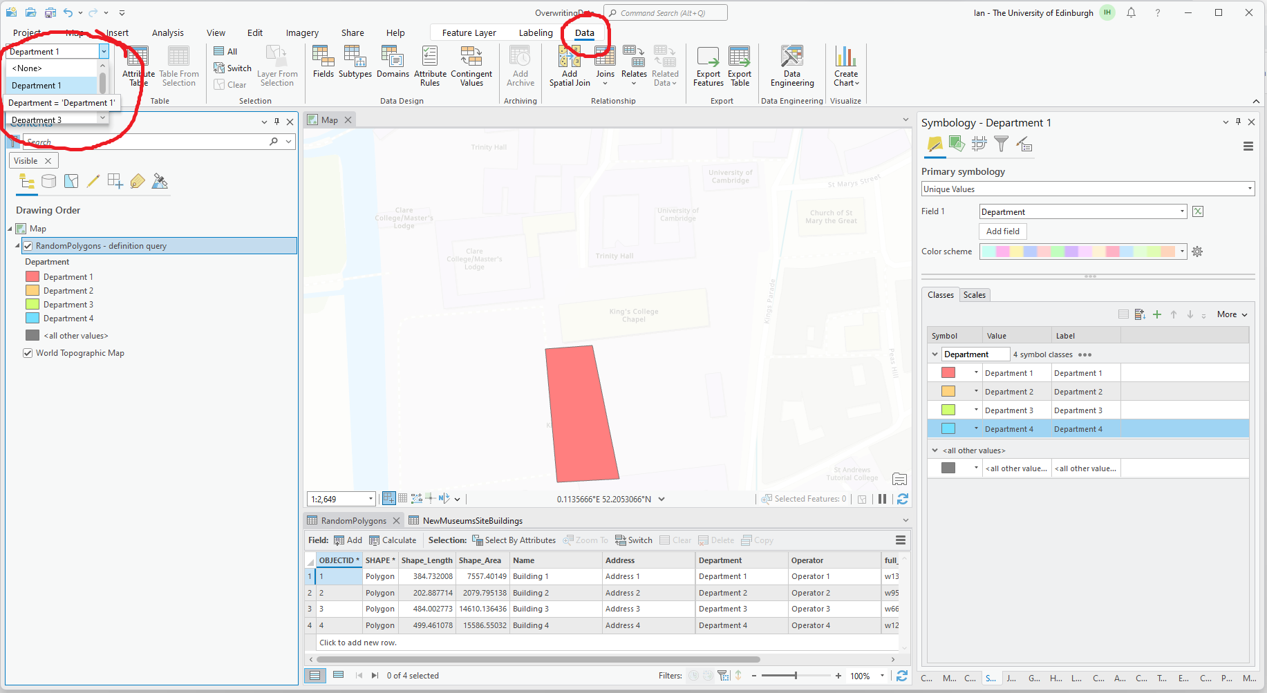

I came across this post [opens in new page] from a few years ago where @KoryKramer suggests creating all the Definition Queries on a single layer then using the layer's Data > Definition Query group drop-down
Again, this kind of gives me what I want but it's a pain to set up and the contents panel doesn't update to show what is being drawn so is a bit confusing.

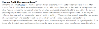

Btw how many Kudos are generally needed for an idea in ESRI to be implemented?
Question | Analyze | Visualize
KoryKramer
Esri Esteemed Contributor
Hi @Ed_ I'd encourage you to read the Frequently Asked Questions about ArcGIS Ideas > How are ArcGIS Ideas considered? https://community.esri.com/t5/community-help-documents/frequently-asked-questions-about-arcgis-ideas...
