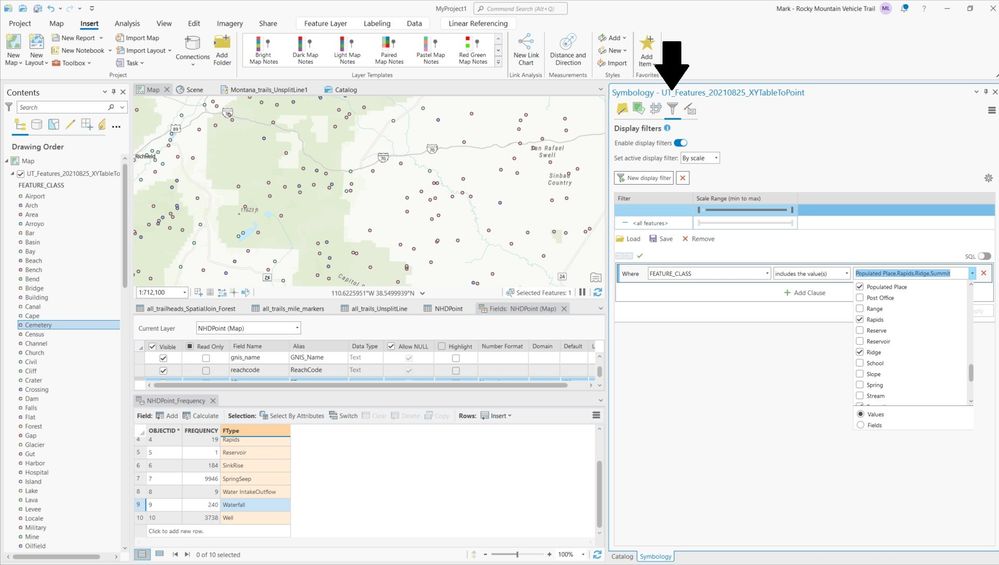

MarkLysecky
The best option I came up with is the filter option in symbology.  I do like QGIS style better but this does have some benefits as well.
you can also use SQL
FEATURE_CLASS IN ('Populated Place', 'Rapids', 'Ridge', 'Summit')

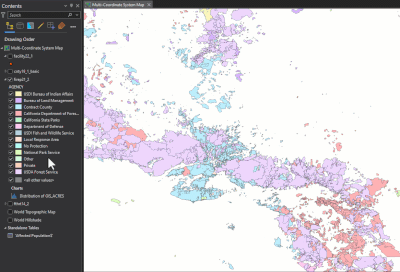

KoryKramer
Status changed to: In Product Plan
 Preview from ArcGIS Pro 3.4 planned for Oct/Nov 2024
