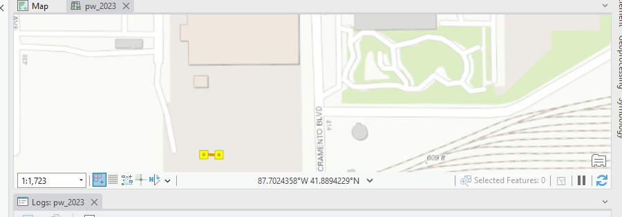

Trying to test adding drone imagery getting error with the RBG image not showing
1840
12-22-2023 03:48 PM
KlimczakAlexandra
: Warning: Cannot compute flight height from input parameters. Use default value: 1.000 m. [DJI_0047]
2023-12-22T17:31:37.177: Warning: Cannot query focal length from input camera properties or built-in camera database. Use value queried from image Exif data: 10.260 mm. [DJI_0047]
The photos were taken with my DJI pro 2 mavic and the EXIF data has the altitude data and all other locational data listed
I would really love some help figuring out what the issue is. I took many more images but wanted to get the basic skill down with two image taken alongside each other at the same altitude.
