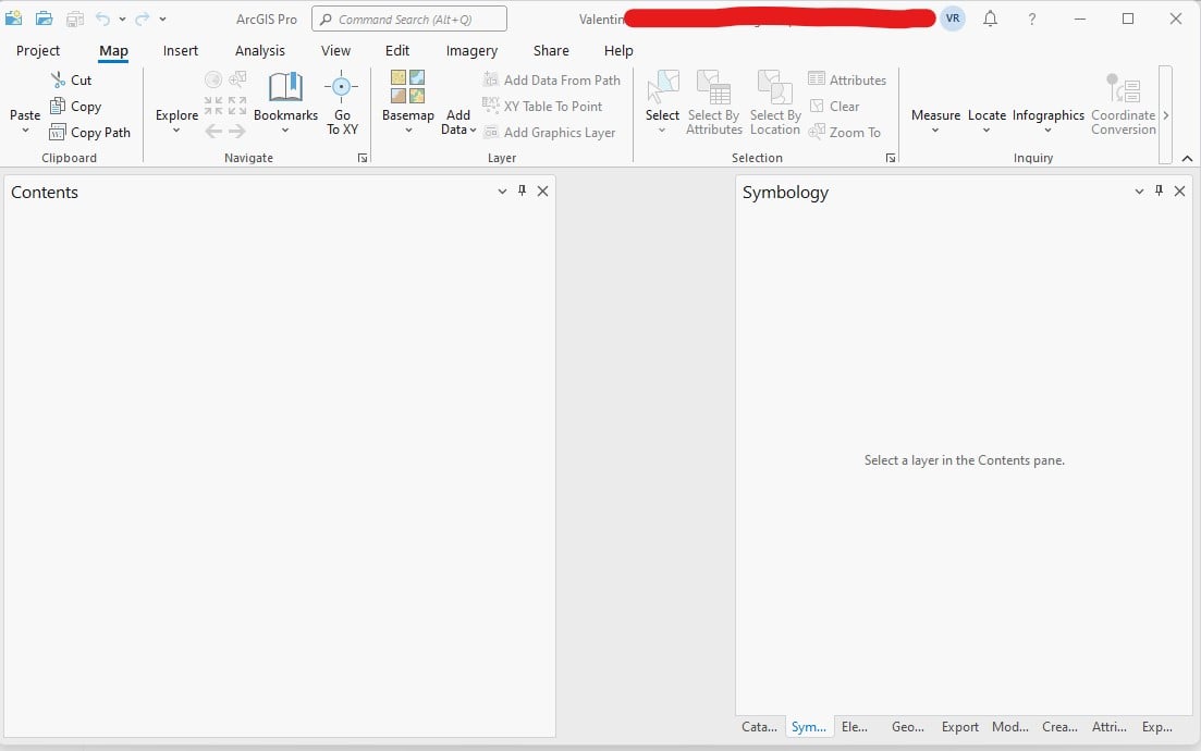

  • If I navigate to my project file in Windows Explorer and try to open it directly, ArcGIS Pro opens but doesn't show the project and freezes  (see screenshot below).
The only way I found was to open ArcGIS Pro, click "Start without a template", and then go to Project>Open and then select a Recent project. But this is not convenient and something should be wrong with my ArcGIS (and if nobody has a solution, maybe someone with the same problem will find this post and use the same walkaround).
