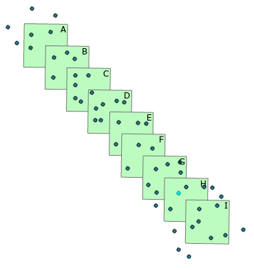

I have a Points FC and a Polygons FC. For each point, I want to get the TYPE value from the intersecting polygon.
Sample fake data:
(The selections are just for demonstration purposes. I will remove the selections when doing the analysis.)
The polygons overlap each other.

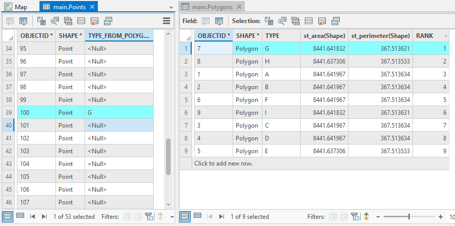

I don't want to generate duplicate points; I want the number of points to stay at 53. I don't want to concatenate the TYPE values of overlapping polygons into a single delimited value in Points.TYPE_FROM_POLYGON.
I want to choose what overlapping polygon to use for each point. I’d use a Polygon.RANK field to prioritize what polygon will be used in the case of overlaps.  A rank of 1 is high.
  1. G
  2. H
  3. A
  4. B
  5. F
  6. I
  7. C
  8. D
  9. E
For example, the selected point (OID=100) would intersect polygons G and H. Due to the ranking, G would be used in Points.TYPE_FROM_POLYGON, not H.
Question:
Using a geoprocessing tool (not Python), how can I use the values in the Polygons.RANK field to choose what overlapping polygon will be used to populate Points.TYPE_FROM_POLYGON?
