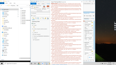

Hi,I have an annoying problem. When I finish the step (Export Training Data For Deep Learning), I try to use Train Deep Learning Model tool. But I input data ,it always display error 032659,just like following pictures. I'm sure all the path (like Labeled Objects, ImageChips folder , emd file, json file ) are in English ,and the properties of input raster is 3 bands,unsigned 8 bit. This problem has troubled me for two months, does anyone have a solution to resolve it? Thanks.

The dialog is incomplete making it hard to figure out what the error is.  But based on what is there "outputmodel" isn't a complete path, you must have typed it since the dialog requires that you navigate to a workspace and select an input.
The other observation is that most of the files in your maps table of contents contain spaces in their names.... that is definitely not good in many situations.
Can you complete the dialog so that the error message has some relevant context.
