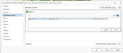

MapGrrl, This has worked for me in the past, but  sometimes when I try this on a table in a GDB, the table name turns light green
WELLID NOT IN (SELECT WELLID FROM CoCalhoun_lith_FINAL_TtE_xlsx_csvET WHERE AQTYPE='R')
When I select Apply I get a Error message: There was an error with the expression. Do you have any suggestions?
