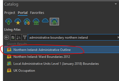

This one?

oh I mean i downloaded a shapefile with UK's boundary to do the clipping!
But I guess using your method will do as well?
