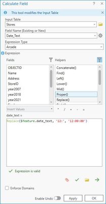

I am trying to populate a new layer based off of some old data I found. However, this one text field that is housing Date info is a little odd. There are spaces between everything and there is a "12:" after almost every entry. How do I get this into my new date field?
4 Replies
Robert_LeClair
Esri Esteemed Contributor
So the first thing to do is replace the 12: in your text field to be a valid (generic) time.  To do this, I calculated the existing text field using the Replace function:
Replace($feature.date_text, '12:', '12:00:00') - see first image below.

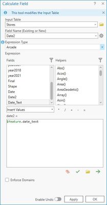

Then in the date/time field, I did another field calculation using the following function:
$feature.date_text - see second image below.
The date/time field now has a valid date/time value that shows 12 noon.

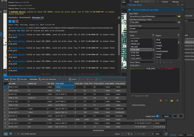

Hm, didn't quite work for me. Not sure where all those 000s are coming from
