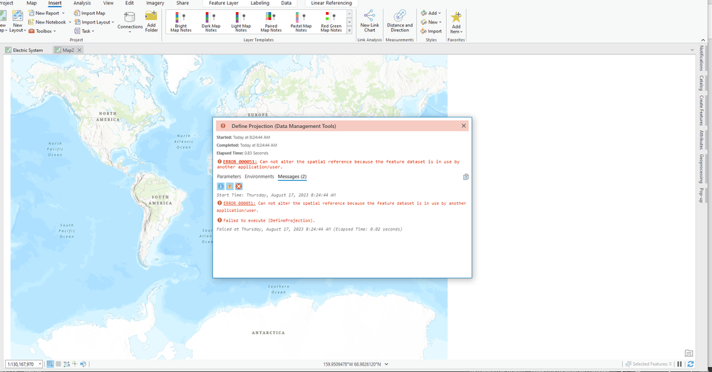

I am having issue uploading shapefiles into my company enterprise dtatabase project. When I try to define projection i get Error 000051:

TylerArruda
Snippet of error message

The Define Projection tool is only used when the dataset doesn't have a defined coordinate system and you know what it is.  Do the defining before you upload it not after

And to add to Dan's response, it also appears that the Feature Dataset has a lock on it as well which prevents any schema changes.  You can do a right-click on the *.sde connection and choose Administration->Locks to see who has the lock.  Once that's identified, you can ask the user(s) to close their ArcGIS Pro applications to release the locks and update any schemas.
Adding to this - there is a BUG-000152217 - "In ArcGIS Pro, the Define Projection tool fails to assign a projected coordinate system for Oracle geodatabase feature classes."  Is your organization using an Oracle RDMBS by chance?

Rob when i go to locks it says I am the one with schema locks. When my co worker is just on it says he has schema locks, but allow him to input the shapefile. So why is it only my account??
