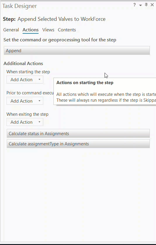

Hello Christine LeslieJason CameranoAmir Bar-Maor‌,ArcGIS Pro Tasks‌ team and ArcGIS Pro‌ team.
I am attempting to use the "Additional Actions" capability of Tasks to both copy attributes and calculate fields either side of an Append function. However, neither are performing as expected. Here are the steps within my task:
  1. Select several points in Featureclass A, to be Appended into Featureclass B
  2. Append the selected points from A to B. Within the Append parameters I set:
    • Input Layer to Featureclass A (including a selection set of features within this Featureclass)
    • Target Dataset to Featureclass B
    •  {location} field of Target to get fieldmapped with {VALVE_NO} of Input (this is a unique ID field)
2a. Additional Action when exiting the step to Calculate Field values into only the Features or records created in this step - ie: only those points just appended to this layer in this step.
Although the Append from step 2 works, the field mapping to pass {VALVE_NO} into {location} fails to occur. Further, the Additional Action supposed to occur at the end of the step to field calculate values into the fields of the features just appended also fails and gives me the below error:
 Please can someone point out where I'm going wrong?
Thanks

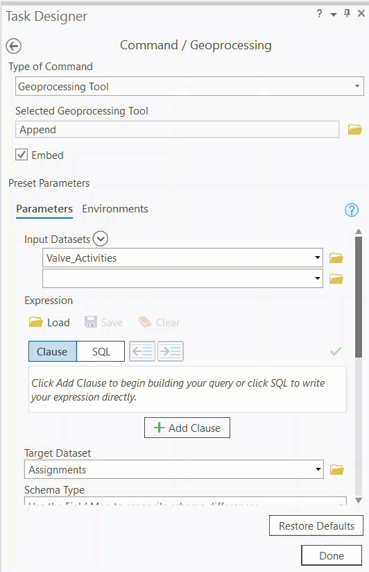

Hello again Christine Leslie ‌Jason CameranoAmir Bar-Maor Charles FernandesArcGIS Pro Tasks‌ and ArcGIS Pro‌ teams. I adjusted my task to try to get something working. It's now configured as shown in the below. Now I:
  1. Select features from Featureclass A
  2. Perform an append from Featureclass A to B and ask the additional actions to create a selection set of these new features appended into B, which I name NEWAPPENDEDFEATURES.
  3. I set the additional actions of the follow on step to start by selecting the features in NEWAPPENDEDFEATURES so the field calculation I use to set some Workforce for ArcGIS‌ values will only apply to these features.
However, as you'll see in the below when I run the task the append occurs, but the selection of features within NEWAPPENDEDFEATURES fails to occur, meaning ALL features inside of Featureclass B get field calculated with the Workforce for ArcGIS‌ values.
Again, any help is appreciated.
