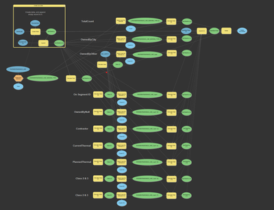

The model builder seems to be doing the trick. It took some time to get my head around some of the problems (for example, using variables in SQL queries when iterating), but I think this will be a useful tool now that it has been put together.
