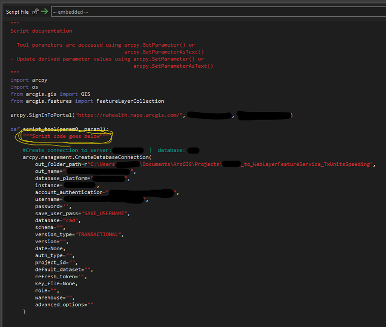

I have a Toolbox Script, where would I insert my script into the solution code?
Like how a black Toolbox Script will show where to insert one's custom code:
