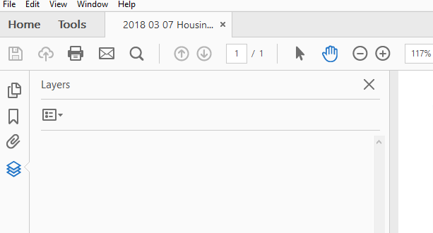

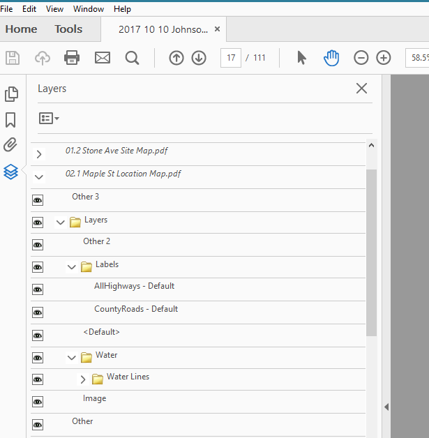

Hello all. In ArcMap when exporting a layout the resulting PDF had layers of all the feature classes, text, and imagery.
While using ArcGIS Pro 2.0.2 and creating PDFs of layouts, regardless if I use the Print Layout (to the virtual Adobe PDF "printer") or Export Layout button, the PDFs have no layers.
Was wondering if that is just something ArcGIS Pro cannot do or if there is an option someplace that I am missing.

Yes. Sorry if it wasn't clear.
I can export layouts/maps in ArcGIS Pro to PDF without an issue. My problem is that that with ArcMap, an exported PDF would have layers of all the features and text of the map that a person could toggle on/off. The PDFs that are exported with ArcGIS Pro do no have these layers.
PDF Exported with ArcMap gives all these:
Layers on ArcMap PDF
PDF Exported with ArcGIS Pro gives nothing
ArcGIS Pro PDF Layers
