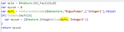

var myid = $feature.COJ_FacilityID
var mysum = 0
var myfs = featuresetbyname($datastore,"BogusPumps",['Integer1'],false)
if(!IsEmpty(myfs)){
  var mysum = ($feature.Integer1/Sum(myfs,'Integer1'))
return mysum
 If this doesn't work, I'm afraid I'm missing something that is right in front of me, but I just can't put my finger on.

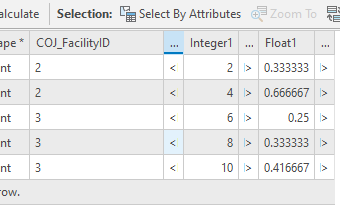

I ran this on the field "Float1" against this data:

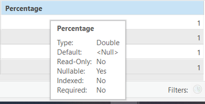

Hmmm... what data type is FullVaccin?  Also, are you using Field Calculator?  If so, what is the data type of the field you are calculating?
godofsix
Long
KimberlyGarbade
If you are calc'ing into a Long also, it might not like getting numbers to the right of a decimal.  Try calc'ing into Float or a Double.
Since percentage is going to be a decimal number by definition it only show 0 or 1 when you calc into an integer type.
if you multiple by 100 it will show an int.
godofsix
Did and still got 1

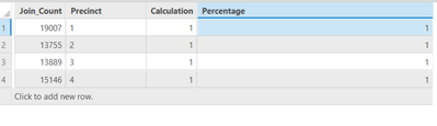

Here is the table:
KimberlyGarbade
Is "FullVaccin" off the page to the left?
Is the table joined with another table?
If you run a calc on Percentage again, and this time just  do something simple like
($feature.Calculation * 1000)/Join_Count
(just using data I see in your table); it will return a useless number, but does that result also show 1 every time?
