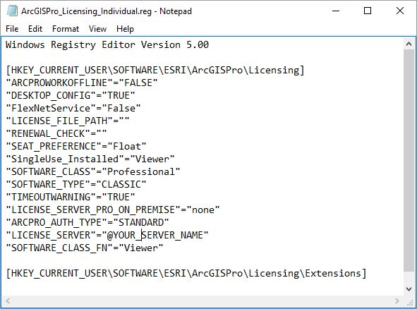

Hello,
Though not the "machine wide" solution like I'm looking for, I did find a set of registry keys that will work for per-user installations.
By running this registry update after the software is installed the end user can avoid having to manually entering ArcGIS Pro's licensing information.Note - this example shows a "Standard" license level, other options are BASIC and ADVANCED.

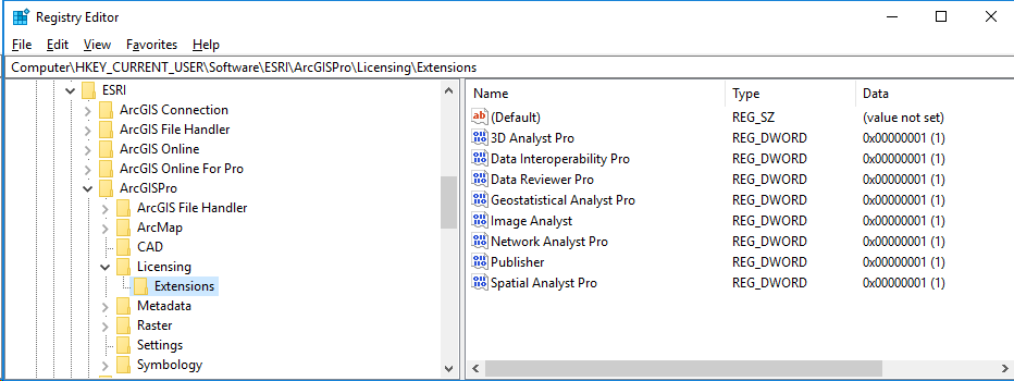

I'm not sure if you have found this (the thread is a couple of years old), but I was hunting for a resolution for the same problem and came across this thread.  In ArcGIS Pro 2.3, the following registry setting will set extensions active without requiring the user to access the "Licensing" option in the Project menu.
HKEY_CURRENT_USER\Software\ESRI\ArcGISPro\Licensing\Extensions

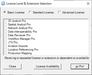

We have built a C# application we have named ArcGIS Pro License Manager that allows the user to select their license level and extensions, these are saved just prior to ArcGIS Pro being launched. This allows 'non' administrators on their local machine to change their license levels and extensions on the fly. *This is something that ESRI should add to their application.
