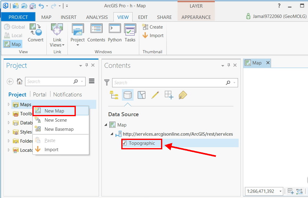

I couldn’t figure out if there is a way to stop adding the “topographic” service each time a new map is created.
How to ban the automatic adding of the “topographic” service?

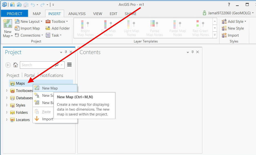

Please, have a look on how I started my project\map. In this scenario, as the map is created, the “topographic” service is automatically added.
I’m not sure if there is a setting that bans the “topographic” service to be added by default to the created map.

create your own template and see if that controls it...I wouldn't be surprised that the blank project defaults to some sort of base layer, if you didn't add it yourself...give the new template a new name like ... a_blank_aprx

Jamal, I think this is the behavior when you create a new map. You're kind of stuck with it.
My suggestion is to create a project with a few maps in it (with the base map deleted) and  save that project as a template.

Yup... that's the way... it is like using a template for a wordprocessing document or a spreadsheet...it looks so much cooler if there is something already there... Create your own...their blank is not your blank
