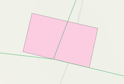

I’m sorry for the late reply. After several tests, and because the polygons may not be enclosed by lines—it could look like this (I have tons of boundary lines and I just need to split the polygons using these lines):
@CodyPatterson  so I converted the polygons to polylines, trimmed the cutting border lines to match the polygons area, and then used Feature to Polygon to get the desired output.
