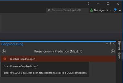

Hello, I am working in ArcGIS Pro 2.9 and am trying to open the MaxEnt Presence-Only Prediction geoprocessing tool (spatial statistics) and immediately get this error when I click on it:
"Error HRESULT E_FAIL has been returned from a call to a COM component".

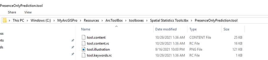

Thanks Dan! It is on my computer and I can find the folder with the tool. I tried uninstalling and reinstalling and am still having issues. It might be time to contact Esri support. Other people can access this tool from my agency.
KelliiWood2
This is what my folder looks like...in case it helps anyone.

If MyArcGISPro is your install folder instead of the usual c:\Program Files location, that may be breaking the python script. (Trying to guess why this would fail on your machine and not your colleagues' machines.) If that's the problem it's a bug that should be reported to Esri.
