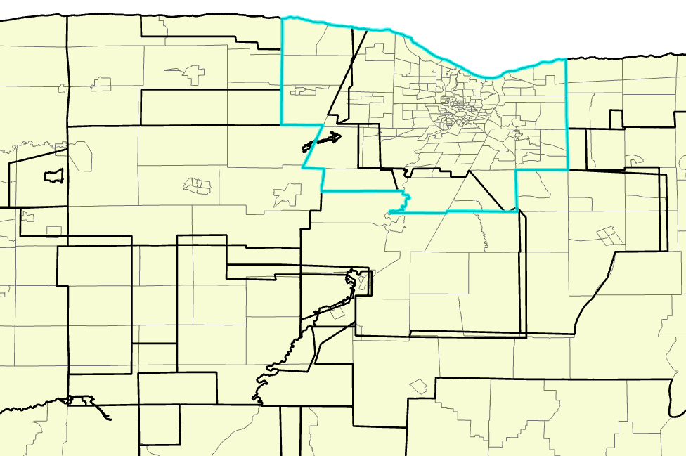

Hi I'm using ArcGIS Pro and I am trying to figure out how to assign the attributes of several overlapping polygons in one layer, to a set of polygons within them in another layer.
This will be easier to understand with the example of the two layers I am trying to analyze:
Layer one:  Visualized with a black frame in the image below. These polygons are overlapping and nested in one layer. Each polygon represents the service area for an electric utility. Some areas are covered by more than one utility and therefore are overlapping.
Layer 2: Visualized in yellow color and a gray stroke. These are the census tract polygons and they are not overlapping.
My goal is to identify for each census tract (polygon in layer two), all electric utilities providing service. In other words - all polygons from layer 1 that contain it, and then add their properties each census tract.

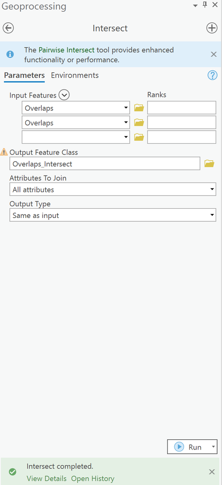

The image below shows what I get when I do a self-intersection of a layer with overlapping polygons. Notice that I get duplicated polygons, so there are six rather than just three polygons. But two of those, the actual overlap, do indeed have different names.
The tool I used is shown in the second image. Can you be more explicit about what you actually did that the attributes were not copied from the two different layers as you can see below?

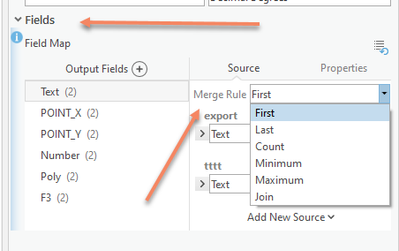

RhettZufelt
MVP Notable Contributor
It is there in Pro.  Once you have the data loaded, you can find it in the "Fields" section:

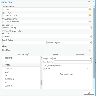

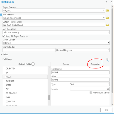

Thanks! I've tried this but it didn't work for me. When I use this function with the definition you specified I get one utility assigned to each census tract, as opposed to multiple utilities assigned to each census tract. I'm attaching an image of my definitions. Did I miss something?
Thanks so much for your help!!
