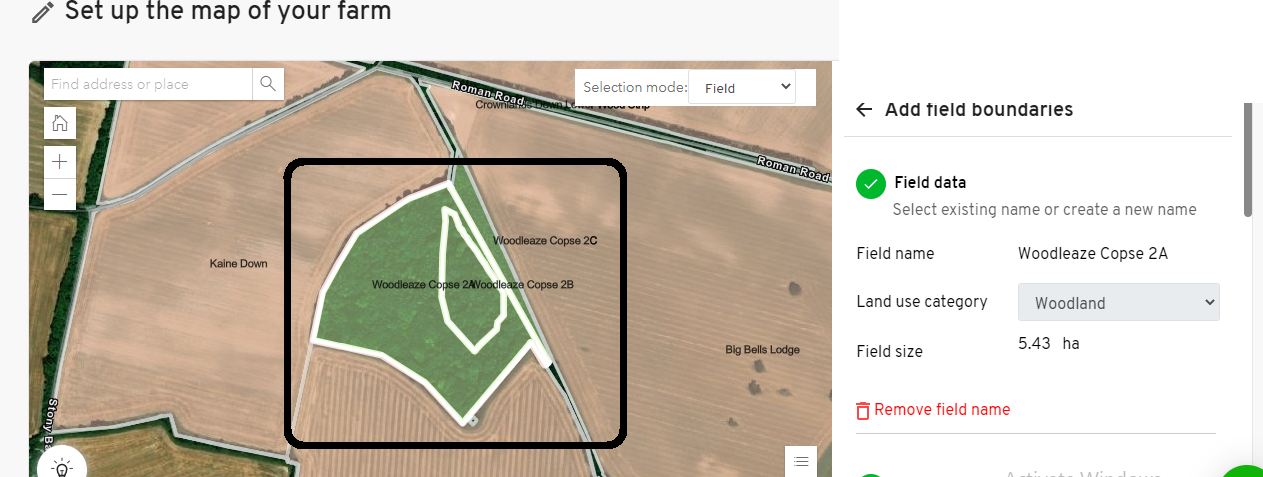

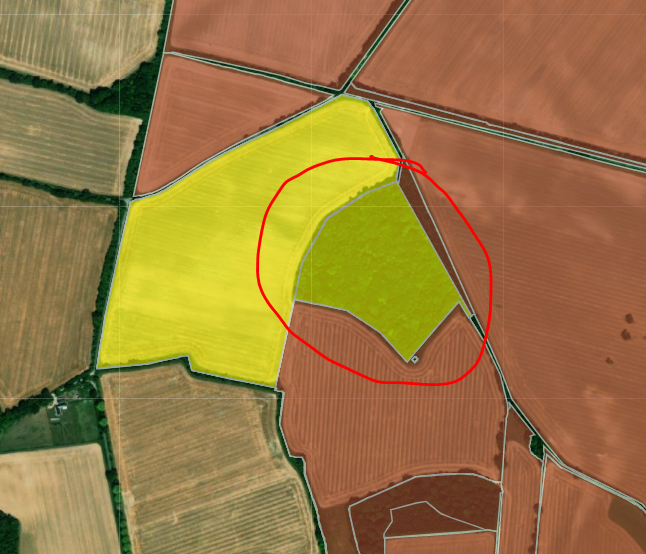

We have a case when we are zoom in at a extent some features disappears. But they come again after zooming more. Check the screenshot below.
We tried deleting old spatial index and re calculating it again using ArcGIS Pro, but with no success. Strangely it behaves differently on different computer.

Does the feature that is disappearing have a scale set?
Amanda Bishop, GISP
SepiHonarmand
No
RhettZufelt
MVP Notable Contributor
Sometimes see that when there is empty geometry or other issues with the source.
Can try to run Repair Geometry GP tool.  That often resolves this issue.
R_
SepiHonarmand
Will try that.
Robert_LeClair
Esri Esteemed Contributor
Another thing to try is use the Feature Class to Feature Class GP tool and copy it to a new fGBD local on disk.  Delete the old FC and then copy/paste back into the original fGDB.  Does the behavior describe repeat?
